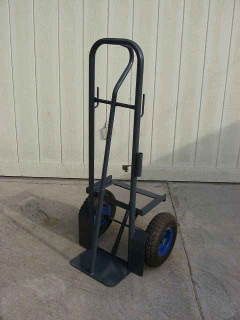

    Hello All! Here's my contribution to the welding cart database, hope someone else finds it useful!
    After rummaging around the archives for a while, the latest 2009 Miller catalog provided me some inspiriation:

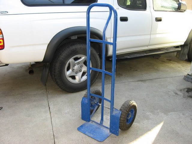

    So for $15 Craigslist supplies the dolly, normally about $50 at Harbor Freight:

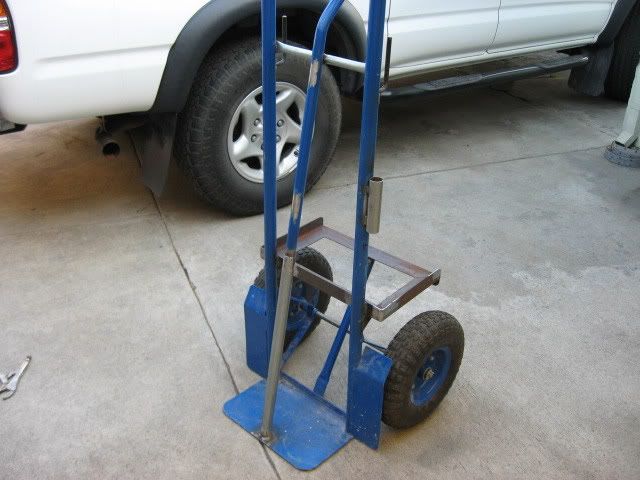

    Cut off the superfluous parts, all the rest came from the scrap pile:
    Painted:
    All done ! (Lincoln SP135+, 172 cuft C25, 83 cuft Ar):
    Thanks! Jeff

      Nice cart Jeff. You might want to dig up a short section of pipe a bit larger in diameter than your tank and weld it down there on the base to keep your bottle from wobbling off the cart.

          Thanks for the comments guys!
          The cart handles great, it's well balanced when fully on it's wheels, even though there's quite a bit of weight. Upright it's extremely stable, I would have to crash my truck into it to tip it over.
          When I picked up the dolly originally, the seller had two to pick from, one had solid tires, the other inflated. For now I'm glad I went with the pneumatics, as it rolls over everything so smooth. We'll see though how long they last.
          During the build I pondered options to secure the tank bottoms. The tanks are strapped very tightly against the center post, you really have to work hard to budge them. As suggested, I thought of welding on a lip, but I really didn't want to lift that large 173cf tank over it. I'll probably fab a hoop of some sort which will bolt onto the wheel fenders.
          And as noted, one of my favorite features is it's very compact, it takes just a hair more floor space than the dolly by itself!
