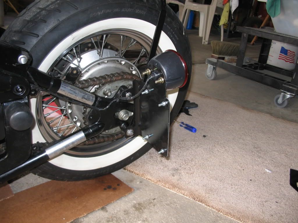

    Well, the reason for me buying a welder is so I can do more work on my bikes. My first project will be a bracket for my new stop light/license plate. The bracket I made now is only 16 gauge steel and everyone says it'll fatigue and break in no time. So I'm going to weld one up out of 1/8" or 3/16" steel. Hopefully I can find some steel this week to make it from.
    Here is the current one I made a couple months back and a link at the bottom to the rest of the bike.

          Triangulation will kill a ot of the "flutter"...I had to do that on a similar side-mount I put on one of my Harleys, and it worked well.
          It'll also help minimize the number of times you (or others) hit the plate with your leg...(happens frequently with sidemounts...especially outside Biker Bars)...and please trim those bolts! (all stainless, I presume).

              Yeah, I'll actually probably just go with 1/8" or 3/16" steel and weld in some gussets as well. I was thinking of doing what you mentioned but the metal is really too thin all around.
              LOL Yeah, those bolts are not the ones I'll be using. It was just sort of a mock up to make sure the plate fit and everything went together right.

                  Nice sled. Good work on that sidemount for the taillight and license plate. I'm into the "old's cool" bobber look, too. "About done with it"? No .... more likely wanting to ride it again. On a project like this, you're never really "done", you just "abandon" it until you think of something else neat to do. Then it's back in the shop.
                  Are you going for a smaller rear fender? Perhaps you should match it with an equally small front fender, too. With your skills, you should be able to fab up something nice.
                  I'd be going to town fabbing up small but interesting little one-off parts, like new brackets, drilled pieces, etc. Anything to make the bike stand out even more. Perhaps a new air cleaner cover is in the making, or twisted steel kickstand.
                  Really, really nice work on that bike.
