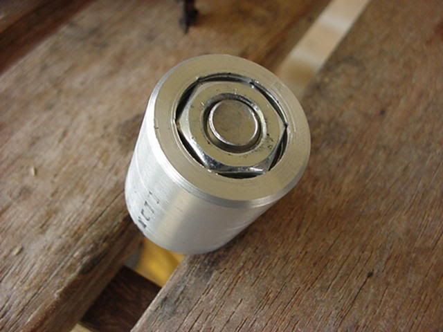

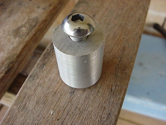

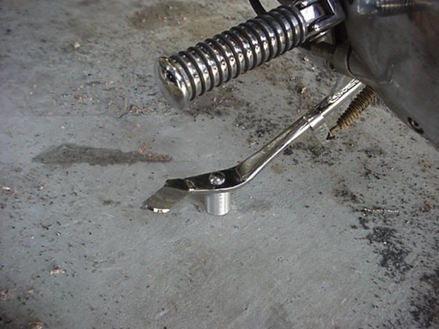

            • #7
              Here is one that a member did to his Harley
              If you need more info just PM me
              Jim

              • #8
                Mr. Jimi,
                That looks like a clean and easy solution. I think that is what Hotfoot had in mind in one of his previous suggestions.
                Is that aluminum?

                  • #10
                    Extended stand....
                    Dom, did you ever try Mr Jimi's idea or are you still riding? I've also got a 91 XLH but not quite as long a front end as yours. My kick stand issue is with a 1970 Yamaha custom street tracker which also requires the 2X4. So what if anything did you do?

                            • #15
                              Originally posted by JoeS View Post
                              I would be hesitant to modify the kickstand by lengthening it. That piece is tempered/heat treated so it can flex. If you've ever seen a full dress or fatboy with a 'fat boy' on it, you would see how much it flexes. If the alloy you use isn't right, I'd be worried, plus the weldment would change the temper. The nice aluminum knob looked cool. I can't remember how the stand attaches, maybe you can use a spacer under the mount for the stand? sure, it might stick down farther, just have to be careful laying the bike down in a left turn.....
                              or just carry around a 2x4" chunk with you. I've seen guys carry a small peice of plate to prevent rollover on soft asphalt. my dad had a soft bag that mounted to the front of the fork near the triple-tree. nice for storing small tools, etc.
                              There's no way to space the mount. The aluminum knob is the simplest idea but I decided not to add any weight to the end of the stand since the spring is just strong enough to hold it up along the frame when riding. I'd be afraid that with added weight, the stand might extend when hitting a bump
                              What kept me from modifying the existing stand by extending is length is exactly what you said ... not knowing what the temper is. The OEM stand looks like its forged and must be heat treated to take out the brittleness.
                              Luckily, there are a few parking spots at work that are reserved for motorcycles and they provide plywood pucks for that purpose.
                              I have a tool bag on my front of my bike. It's filled with tools and emergency repair stuff. With a 27 year old bike, you don't leave home without it
