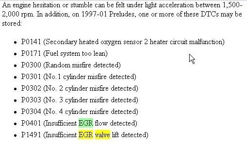

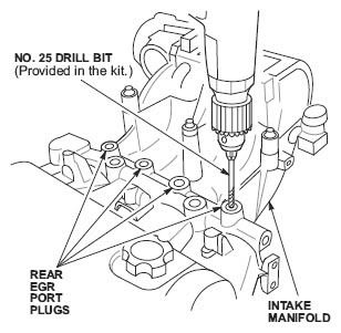

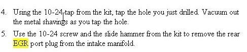

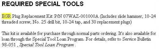

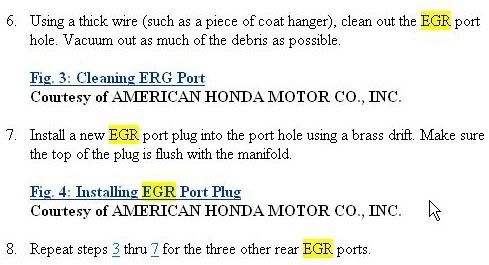

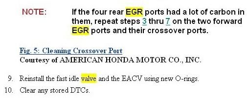

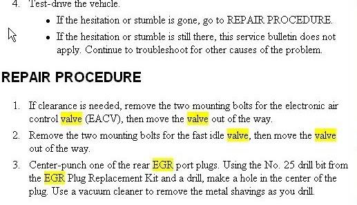

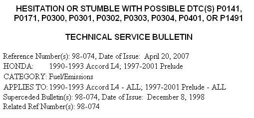

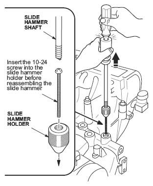

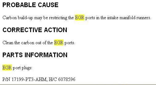

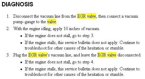

                  Go to www.honda-tech.com What you are describing is a common issue usually related to plugged ports in the exhaust gas recirculation passages. Look under the FAQs for Accord EGR Port cleaning.
                  Not that difficult - essentially pull 4 plugs using a home made slide hammer (Read self tapping screw welded to end of carriage bolt) and clean out the ports with a wire and compressed air. Took about an hour - problem solved.
                  Course - could be something else - but this is common.

                      ADMITTEDLY: I opened the hood and my mind slammed shut.
                      If any of you can expand on this EGR stuff.
                      I will be in debt, like on the god-father movie.
                      Call me in the midst of your worst night-mare.
                      I will help you sort out the thing.
                      Here are both posted & hosted pics of the engine compartment.
                      I don't see anything that whispers only an hour here.??
                      If you can find the time to paint the pics with arrows shot into the culprit,
                      I will be your servant in the future, when the unfixable occures.
                      Remember the 318 the 429 the 283 I'm still back there, intellectually.

                      • #12
                        Hope this helps.
                        556man

                            Some auto parts store can do a free use of their scanner to give you the problem code. Should help you in pinpointing or giving you a clue on the problem. Mine had a misfire on cylinder 2 code which led me to the bad plug.
