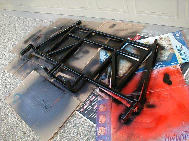

                          Thanks for the nice words about the lock setup for the toolbox. Also I agree about the padlock, and that will change soon. The box itself does lock, but only enough to keep the honest guy out. I apologize for the lack of info on the rack.
                          1 1/4 14 ga was used on the horizontal. I stacked the bottom tube to offer a bit more support. I probably didnt need it but what the heck. The legs, which there is 3 on each side are built from 1/1/4 tube with 1/8 in wall. Again I am sure that was over kill. Everything was welded with 7018 dc. It was a good project to practice.
                          Thanks to my neighbor the legs lay inward to the angle of the cab, which I thought turned out looking very nice. Rather then the straight up from the bedside. I also made the rear and center cross brace removable for access.
                          Most racks I have seen have the angle under the legs with the lip down. I really didnt have much motive when I planned this other then I have single chain links welded to the top edge for tie-downs.
                          So far this rack has proved to be super strong. I brought home my top for the weld table atop the rack. This was 1/2 inch plate 36 inchs wide by 13 feet long. I dont know even a guess on weight but the 2 ton engine hoist really didnt want to pick it very well.
                          I may add, I dont think I would have hauled the steel that high in the air with a half ton. This pickup is pretty hefty in the springs even tho it says it is only a 3/4 ton. So far if I can get it on the rack and tie it, thats where it goes.
                          Having the full rack will for sure affect your millage. Mine went from 16 to 9 mpg. This was a real bad deal when gas was 3.90 a gal. Since I only drive this pick up for work the mileage change didnt hurt to bad. My gas figures in to every job, and any friends wanting me to haul for them get to fill it up when we finish. I am a nice guy and always start with a full tank.

                          • #15
                            rack pics
                            finished my rack. thought you guys would like some pics. thanks for all your help. let me know what you think.
                            Will
