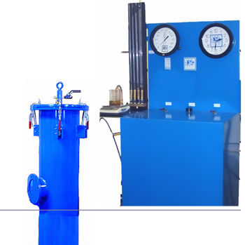

                This link shows hydro being done and explanes process.
                This link has DOT regulation governing hdrostatic testing of cylinders.
                Burst disk on cylinder valve is stamped with pressure at which it will burst and should be the hydrostatic test pressure.
                As stated before cylinder valves with pipe threads are replaced by new valves after hydro.
                Scuba cylinders use straight threaded valves with O-ring seals so valve threads aren't damaged by installation.
