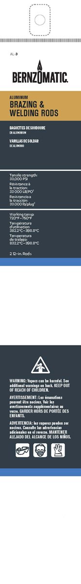

    I bought a Air / Acetylene TurboTorch and some BernzOMatic AL3 aluminum brazing rod. I clean the metal with a Roloc pad, the torch heats up the metal fine and the brazing rod melts nice and smooth but after the joined pieces cool down I really dont have any trouble pulling it apart. once its apart I can see there was really no penetration to speak of.
    I am not using any type of flux, no one in the videos I watched mentioned or used it. It this the problem? What am I missing?

            There will be no penetration in brazing. Granted, all my experience is brass and copper, but I do a lot of that. What is your joint design?
            EDIT: Or are you referring to the filler penetrating INTO the joint by capillary action? But same question: what is your joint design?
            EDIT: Bernzomatic addressed this question on their website with this reply: "When soldering aluminum to aluminum, flux is not necessary. It can help, but it is not required for a good seal. If you wanted to go this route- I would recommend our PF200 Petroleum based plumbing flux."
            The [email protected] Aluminum Brazing and Welding Rods are ideal for soldering or repairs. Working temp: 720-750Ëš F. Tensile strength: 33,000 psi.

              I see now it says flux is not necessary on their website but it says nothing about it on the package. They recommend PF2000 plumbing flux if I want to use some. Everyone else says you dont need it or you can only use flux made for aluminum. ???

                          MAC702 is correct in saying Bernzomatic says you don't need flux with their AL3 rods but I sure dont see any flux on them and they are NOT working. Then they recommended using plumbing flux. I'm pretty sure that's incorrect.
                          "Thanks for reaching out to Bernzomatic. I apologize that Lowe's was not able to answer this for you. When soldering aluminum to aluminum flux is not necessary. It can help, but it is not required for a good seal. If you wanted to go this route- I would recommend our PF200 Petroleum based plumbing flux."
                          I got some Blue Demon rods locally that say they are flux coated on the package so I will give those a try and see what happens!!
