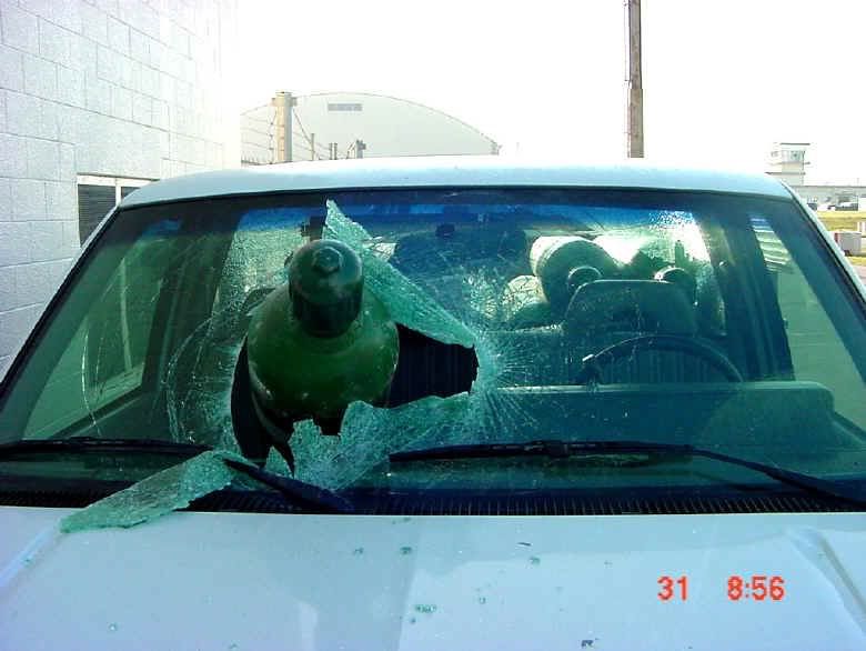

                        There have been major accidents when gas bottles were hauled inside car. Maybe fuel gas or O2 leaked and or HP bottles were not properly secured to prevent movement during normal driving let alone during accident. They are trying to reduce legal exposure to customer's stupidity. Local Airgas dealer told me they would not sell CO2 for filling paint ball gun tanks. Some teenager had accident filling his tank.
                        • #13
                          Ya mean accidents like this?
                          • #14
                            Boy, I bet someone needed new shorts!
                            • #15
                              I hate hauling cylinders for that exact reason in that picture. I always secure mine so they can not move. When I haul my large t cylinder I strap it to my car with a strap around the neck and into the cap.
