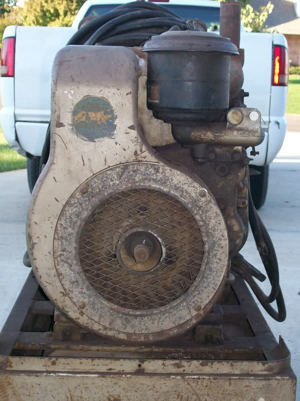

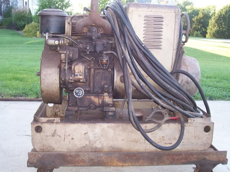

    I recently inherited the welder from my uncle who passed away.
    I finally went and picked it up today. It has been sitting in a shed for about 20 years.
    I'm looking for any info I can find on it. I read a post by someone on this board with a contact that may be able to provide some info.

      I'm looking for manufacturing date, manuals, wiring diagrams, in general, anything that is available.

        The unit was manufactured 1/25/1954, tested 1/26/54, and sold to A P Equipment in Kansas City, MO 2/16/1954
          Thanks Bill!
          I live in the Kansas City area, so it looks like it didn't travel too far from home.
          My uncle after getting out the Navy during WWII, started and ran an ornamental iron business. He may have purchased it new.
          Now on to getting it to run and weld. I pulled the head off last night as it didn't have any compression. Both exhaust valves were stuck open. A little penetrating oil and they freed right up. The cylinder bores look excellent. I put the head back on for now, I'll try to get a new head gasket.
          It has plenty of compression now, but no spark. I cleaned the points in the mag, but still nothing. Hopefully I don't have to have it re-magnetized.
          Next I'll tackle changing the oil and cleaning the carb, fuel filter and gas tank.
