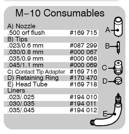

    I have a Hobart chart that says when using Flux core wire and welding material 1/4 to 3/8 inch it recommends using .045 wire. I understand the ironman 210 will not use wire over .035. Will .035 wire work well on 3/8 material?
    That's incorrect. See pages 22 and 23 of your owner's manual.

        Zrexxer, I don't have an owners manual, but lookig it up on the internete shows that the Ironman 210 only used .023, .030 and .035 wire.
          Page 23

            Oh, but you DO have a manual, you just haven't read it. It's right at the top of the page, available for free:
            Anyway, like I was saying, page 22:

              I stand corrected, but if you put ironman 210 in your browser and look at the specification sheet it only shows ;023 , .o30 and .035 wire
              • #8
                IM210 & .045 wire
                To run the .045 flux core wire you would need to purchase the optional feedroll, gun liner and tips.
