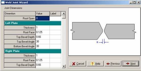

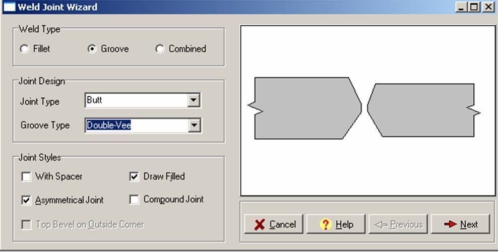

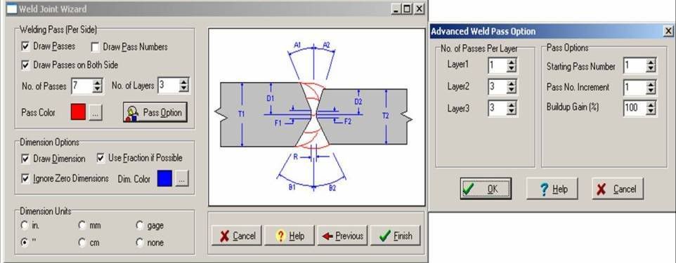

    Every imaginable joint design can be pulled up
    All attributes of the joint can be changed

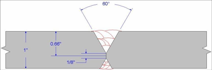

    You end up with :
    Pretty neat for free software !
